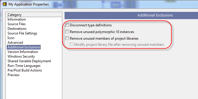

try to remove all check marks in the build spec app properties as shown below:
This might help.
Andrey.
