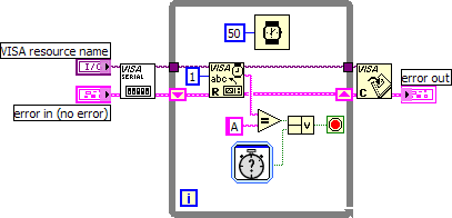

It would just be a while loop with a VISA Read as in the attachment. You probably also want that if the timeout occured by whatever time you use with the elapsed time function, an error would be set.

Dear Dennis
Thanks for your help I have labled for you an icon in the example you gave me in LabVIEW that I dont get it , could you please tell me about this VI or Icon what does it do , attached is your example with the icon being Labeled
Message 4 of 29
(4,974 Views)
VISA Wait on Event will only wait for any serial character - not a specific one like you asked for.
The function you ask about is the compound arithmetic set to OR mode.

The example I posted will do what you want except for the write portion. After the serial port init, just add a VISA Write and send the 'A. The while loop will then wait for the 'B' character. You could also put the Write inside the loop and continuously send it and then do a read.
Since there is an error out connection from the while loop, put whatever code you want after the while loop and just connect the error clusters.
