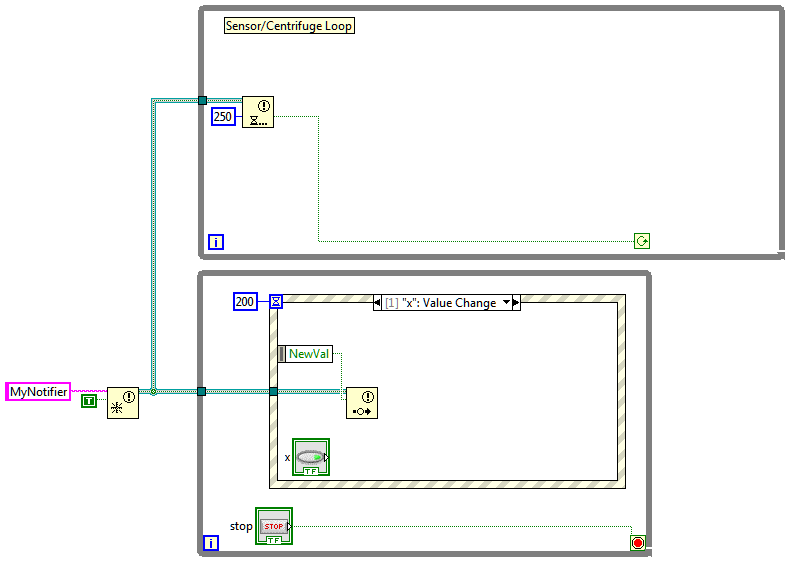

Ok, now you want to have both loops running in parallel. Take a look at the Notifier operations. You can use them to "notify" your sensor/centrifuge loop when the count down or button press occurs. (Use a small timeout value for the Wait for Notifier so your loop isn't slowed down too much).
Also, I would recommend a user event structure to handle the button press/count down (surround it with a while loop). Example:
Hopefully that will get you started. (Don't forget error handling that I omitted for brevity)
