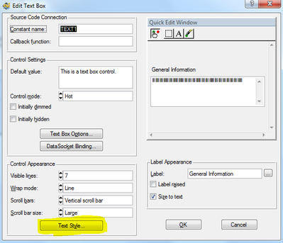

You should be able to display barcode fonts by changing the Text Style for most user interface text controls. Below is a screenshot of a user interface displaying barcodes.
I did this by opening the Edit window of my Text Box Control and selecting Text Style.
Then I changed the Font to a barcode font.
Hope that helps.

Hi Rohama K,
The fact is that i don't find the font of bar code 128 in the list of fonts when openning the window of Text Style.
I need find the way of loading a new font to labwindows.
Best regards.
