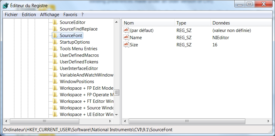

I'm comming back to this old thread because I want to use Greek (Math) caracters on the uir but the "Symbol" font available in other windows applications (like NotePad) does not display in the font selector in the user interface editor.
I have taken a look at the registry but couldn't find out how to change it in order to get the symbol font.
Here is a screen shoot of my registry.
Could some one advise me what I have to add?
Message 8 of 9

Sorry for this post.
The solution is to choose the right Character set
