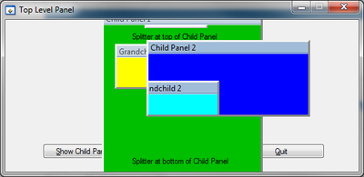

I'm attaching some pictures so that there's no confusion over what I'm talking about. I'm using the userint/panels.cws, but I modified childPanel1 to be the exact height of the parent panel as you can see in this picture taken from the UI Editor:
If I don't programmatically set the top of the panel and auto-center vertically is not set to true, then I get this when the panel is loaded. You can see that the panel is being cut off because it loads inside the parent panel using the top value set in the UIEditor.
If I set the child panel to auto-center vertically it looks like this. You can see that the child panel's title bar is partially obscured due to the auto-centering, and the splitter at the bottom of the child panel is not visible.
If I then programmatically set the top and left to (0,0) I get this. The frame of the child panel (including the title bar) is hidden, but you can see that everything on the panel is visible:
If I programmatically set the top to 30 it looks like this. The title bar is visible but you can see that the control at the bottom of the panel is now no longer visible:
I'm assuming that you're seeing the behavior in the 4th screen shot when you set the top to 0 and something similar to the 5th screen shot when you set the child panel top to 30. I'm guessing that due to the font being used on your machine, the thickness of the child panel title bar is actually 30 so it doesn't stand out quite as much as mine.
When setting the position of a panel inside another panel, the frame (which includes the titlebar) is ignored, so that (0,0) cooresponds to the very first pixel that is actually visible in the panel. I'm guessing that what you want to do is either:
A) Disable the titlebar in the child panel and set the frame thickness to 0, or
B) If you need the titlebar of the child panel to visible, change the height of the of the child panel to be = (height of parent panel - 30).
