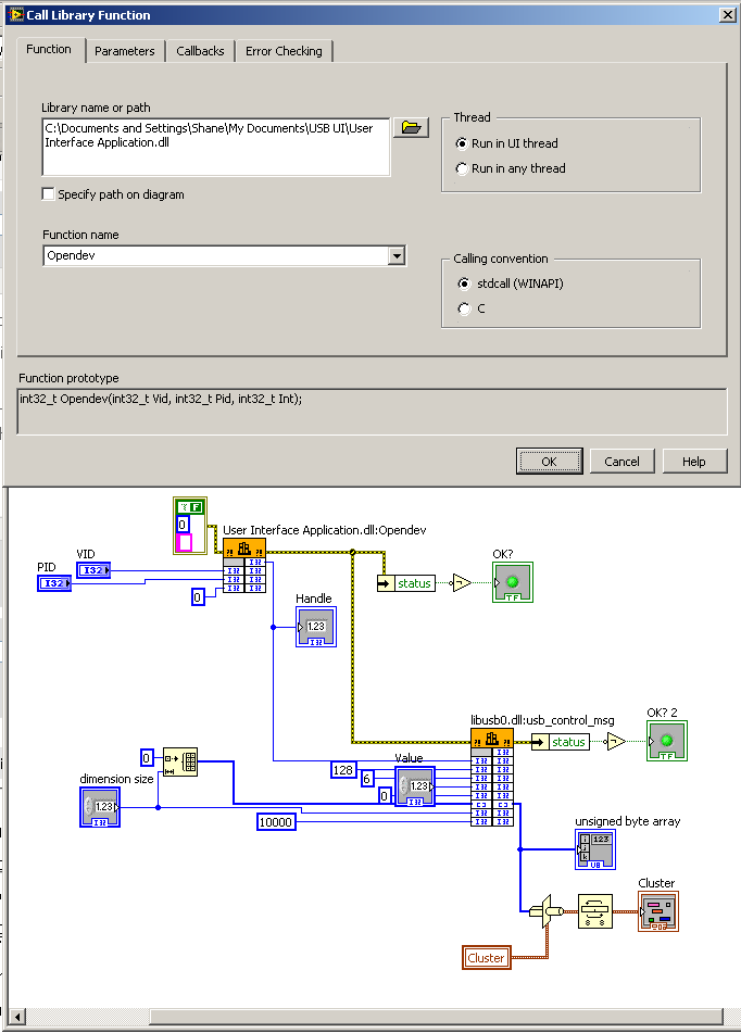

Below is a pic of my DLL call in LV.  Nothing really special there.  Of course I'm treating the returned pointer as an I32, not a pointer (Since LV doesn't allow those).  You reckon the problem could have to do with that?
Would that explain why it only gets returned on the second call after assignment?  Seems like pretty wierd behaviour to me.

WOW! Your C skills might be a bit rusty, but my LabView ones simply do not exist! You might as well have posted a Jackson Pollock painting, for all the sense your diagram makes to me Smiley Very Happy
One line of thought springs to mind, though: did you set the calling convention to match the one used when you built the dll? Mismatched conventions have been known to produce very odd results.
I can't tell what LabView does with the return value - I wouldn't expect a C program (in a 32 bit environment, anyway) to have problems with the intrinsic cast from a pointer to an int, but, to be on the safe side, I would try using an unsigned int or even an unsigned _int64 (or whatever the LabView equivalents are) in the LabView panel for the prototype, just to eliminate this as a possible problem.
So how do you know what the return value is? Presumably LabView has similar debug/variable inspection facilities to CVI? What value does it show, compared to the value printed in the message box?

Did you just say my LV code is a load of Pollocks?  :smileyvery-happy:
Changing the calling convention is pretty much the first thing I try to change if things don't work as expected.  I've exhausted that avenue unfortunately.
I'll try a U32, but I doubt it'll change anything somehow.
In LV, the value is exactly the same as in the DLL messagebox (when it's returned).  On the first call it's always zero.  NULL.  Maybe it's a LV allocation issue.....
