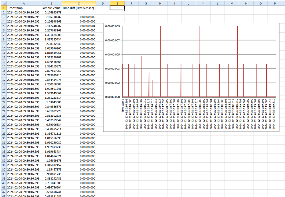

As far as I can see there is an evident problem in how timestamps are calculated and stored in the Excel sheet.
This is your sheet modified in order to show timestamps at millisecond level. This reflects in time difference calculation, as you can see in the third column and the graph next to it.
I am puzzled as to how that datetime.datetime.now() function works, but as it is evident it does not create a linear evaluation of time, which you could calculate by yourself based on time of task start and actual acquisition rate (which you can query from the task and could be different from your settings).
