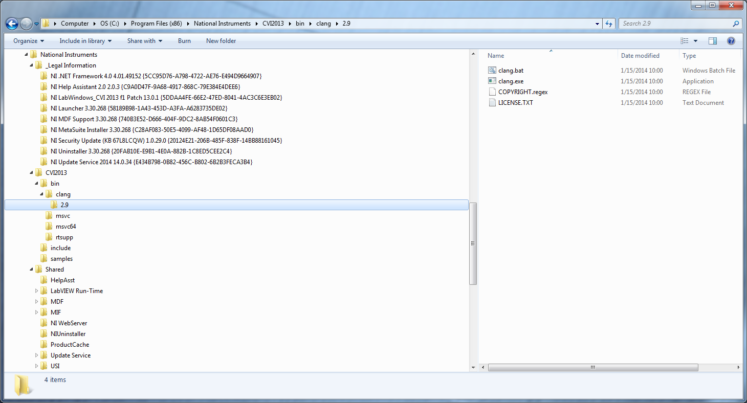

Today I have uninstalled CVI2013 SP1, i.e., all NI software except the Update service, see Fig. 1 below. However, looking at the files and directories left after de-installation I am, hm, disappointed... Why is so much left over, see Fig.2 below...?
Should I clean it manually / is it safe/recommended to clean it manually?
Fig 1: After Uninstalling CVI2013 everything looks fine
Fig.2: Everything? Well, not really... why are these directories not cleaned and removed during de-installation? I don't think they are needed for the update service...

Some additional information:
After de-installing NI Update Service the number of files has decreased remarkably (but still is not zero), see below.
It appears that patches are not de-installed with the product but with Update Service, e.g. for CVI the patch f1...
