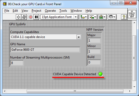

Getting started:
At the first please open example "00.Check your GPU Card.vi" (should be located in <LabVIEW 2009>\examples\ADVision\NPP Examples), then run it.
If your GPU is supported, then you will see something like that:
After that you can open other examples and see how it works.

Hi Andrey,
I want to congratulate you for this great toolkit, is exactly what I needed.
I have just bought an GTS450 videocard to use it in my image processing projects.
I have checked the NVidia website for how many Processor Cores this videocard has, it says 192.
But when I try you're example it says number of streaming processors = 4 !!!
I am a bit upset since is lower than you’re 9800 videocard
There is any way I can use more of these Streaming Processors to have my computations done faster?
Please Help.
