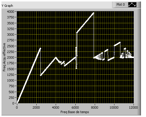

How much fun...
Before my coffee break, I thought I would automate a little test routine to graph actual acquisition rate vs trig rate.
Here's the test routine :
And here's the result trig rate on X axis and actual acquisition rate on Y axis :
So if I want to be able to acquire between 3 and 4 kHz I have to trig at twice the acquisition rate I want, but if I want a less than 2 kHz I have to trig at the rate I want.
