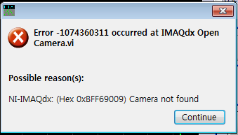

Upon disconnecting the "CMS" camera, an error message as the following occurs.
"Error-1074360311 occured at IMAQdx Open Camera.vi
Possible reasons: NI-IMAQdx: (HEX 0xBFF69009) Camera not found"

-IMAQdx Open Camera will have drop down control to select the camera to be selected.
-If it is left/blank IMAQdx Configure Grab tries to Open camera "cam0" by default hence your CMS camera is opening by default.
-If your third party vi allows you to select camera then change the camera name.
-Else, change Basler camera(scA640-70gc) to "cam0" and CMS camera to cam 1 or other name.

Wow... such a simple modification and it worked...!
A week I have spent on trying to solve this problem, and I'd like to express my deepest gratitude.
