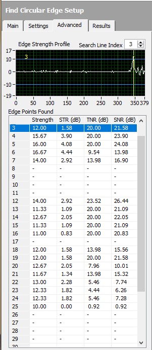

I am trying to extract the identified edge points while performing a Circular Edge detection using LabVIEW Vision.
Using the Vision Assistant, I can see these values however there is no way to export them. I can only export the Results.
When I export the script to LabVIEW, I can get the identified circle but not the full set of points.
Is there a way to get these values from within LabVIEW?

I think you could use IMAQ Spoke to return an array of the detected points. If you give it the same settings as IMAQ Find Circular Edge I would expect them return the same points.
(4,022 Views)
From an initial look, that should be what I am looking. Will give a bit more testing tomorrow when I'm back in the office.
