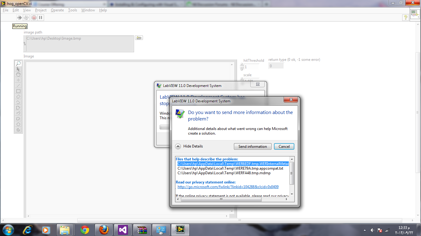

hello, i took the files posted on your blog (vi,dll file, c++ code) but when i am trying to run the vi some kind of error appears(please see the attachment) any idea?
Message 8 of 24
(7,923 Views)
please attach the error.

Message 9 of 24
(7,921 Views)
Message 10 of 24
