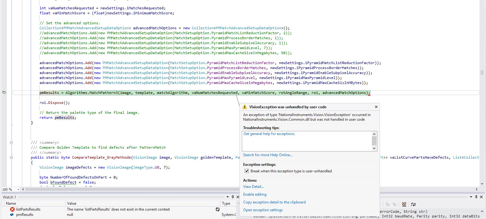

I am trying to dynamically learn a template for grayscale pattern matching.
 I am programming in C# and I have Vision Development Module  2013 SP1 installed.
I’m calling the PatternMatch3(VisionImage template, etc…) function.
If I create a template image in Vision Assistant and save it to a .png file. Then open it in my code using VisionImage.ReadVisionImage()
PatternMatch3() works fine.
As I said, this does not help me. I need to capture an image using a frame grabber, then extract an ROI, then create a template from the image I extract from the roi.
I tried using LearnPattern() to train the template, which works without an exception. But, when I try this template in PatternMatch3(), I get the following error
ErrorCode.TemplateDescriptor=-1074395247 - Invalid template descriptor.
So, I dug a little and found LearnPattern2().
LearnPattern2() method accepts a parameter that is a collection of PMLearnAdvancedSetupDataOption values as one of its parameters.
I’ve tried creating a collection of PMLearnAdvancedSetupDataOption parameters that match the PMMatchAdvancedSetupDataOption used in PatternMatch3().
But, no matter what I try, I keep getting the following error when I call LearnPattern2()
Clearly there is Vision Information in the template file that holds the data needed for a valid template that works.
My question is, how the heck can one set the Vision Information in a dynamically created template using LearnPattern2(), so that it would be the same as the vision information when you open a previously created template in a .png file using ReadVisionImage()?

I have problems with LearnPattern(2) and PatternMatch3(), too. Sometimes, not always, gives in my code "PatternMatch3()" for the same template  "Invalid template descriptor" error. What I don't understand why I get error. My template (for same template) must have either always "invalid template descriptor or always valid template descriptor. But not random.
I'm using for pattern matching "gray value pyramid". So I must use "LearnPattern2()" with advanced setup data options.

John,
I know now why I get "Invalid template descriptor" error/exception.But knowing this not solves my problem and knowing why this problem exists makes me just angry against NI.
All my templates are OK. Problem is, NI Vision .NET is 32-bit and supports memory just up to about 1.2GB no matter how much memory your PC has.Depending on your image and template use MatchPattern3 a lot of memory. For example in my case about 350 MB. If your program uses at the moment before calling MatchPattern3 about 900MB memory then exceeds NI Vision .NET this 1.2 GB (maybe 1.1GB) upper limit and can't load template right template and gives out an exception. That's my experience. To find out this have I wasted many days!
I thought I make mistake in template generating because of this !@& "invalid template descriptor" exception. Actually it must like "not enough memory" or something similar.
Devrim
