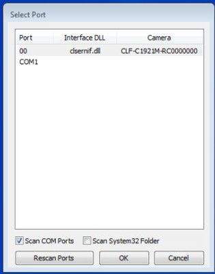

For example I have Imperx Cheetah camera connected. When I start Imperx configuration software I get screenshoot1.  
Then I select selsernif.dll that is connecting the camera through the virtual port and click OK.

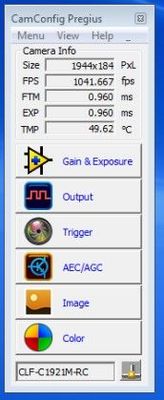

I get the camera configuration menu.
That is telling you the Frame Grabber works as expected.
