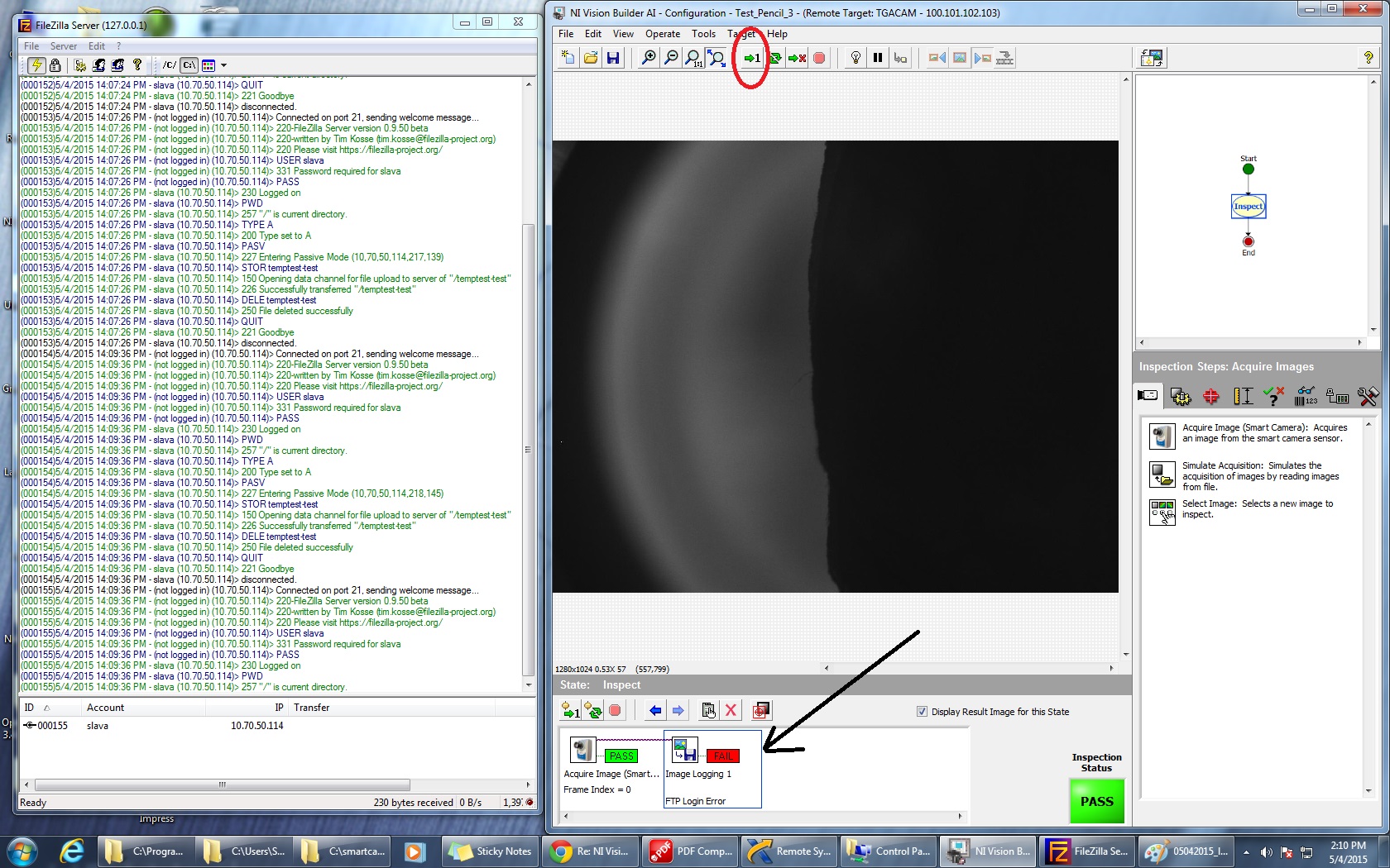

Brad, thanks for your advises. I run the program by clicking the button on the top. It turns that the image logging step fails, as attached (I also tried the inspection mode, same thing). The operation does not add more message on Filezilla. If I use the button on the bottom, there is no error on the FTP setup.

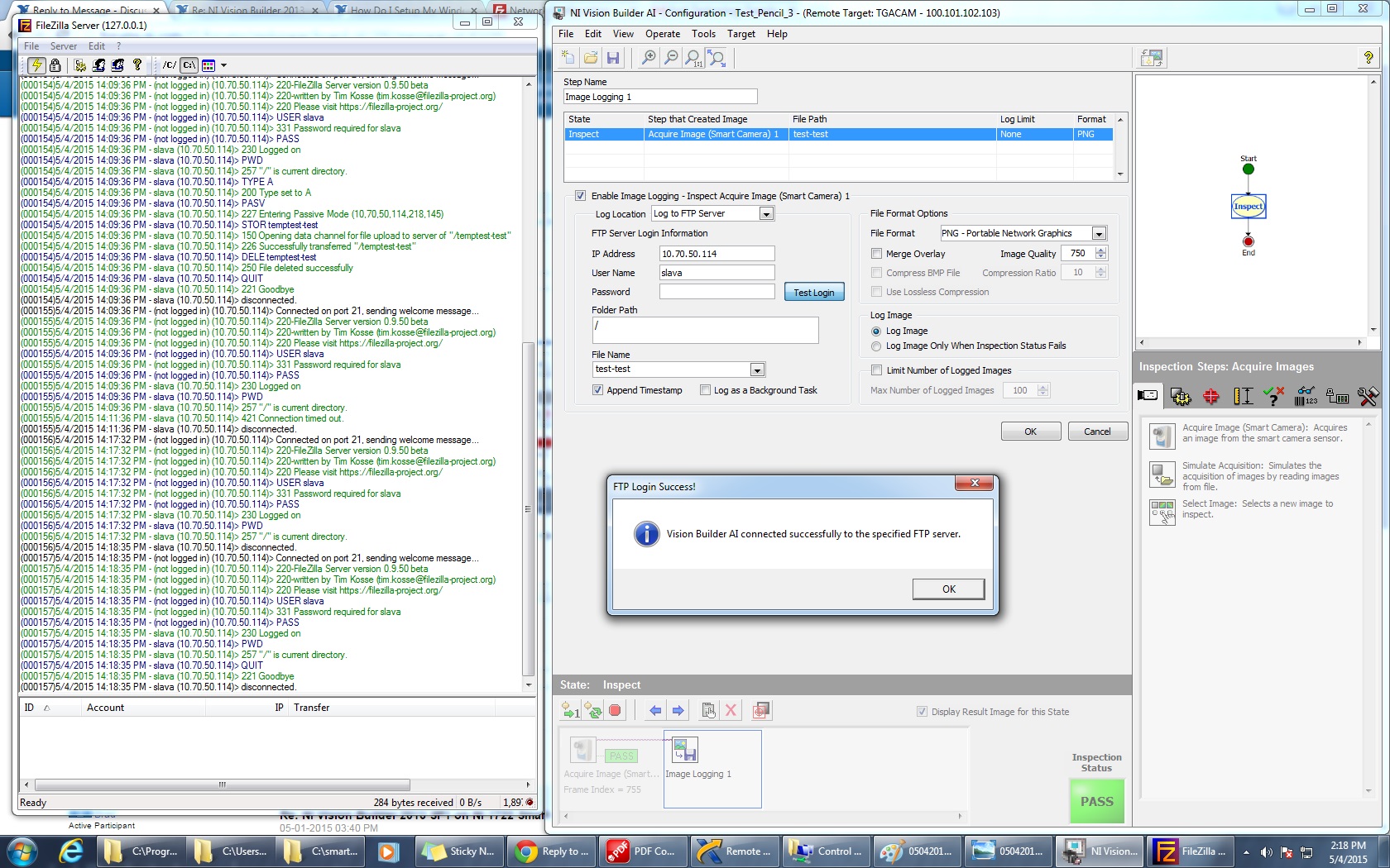

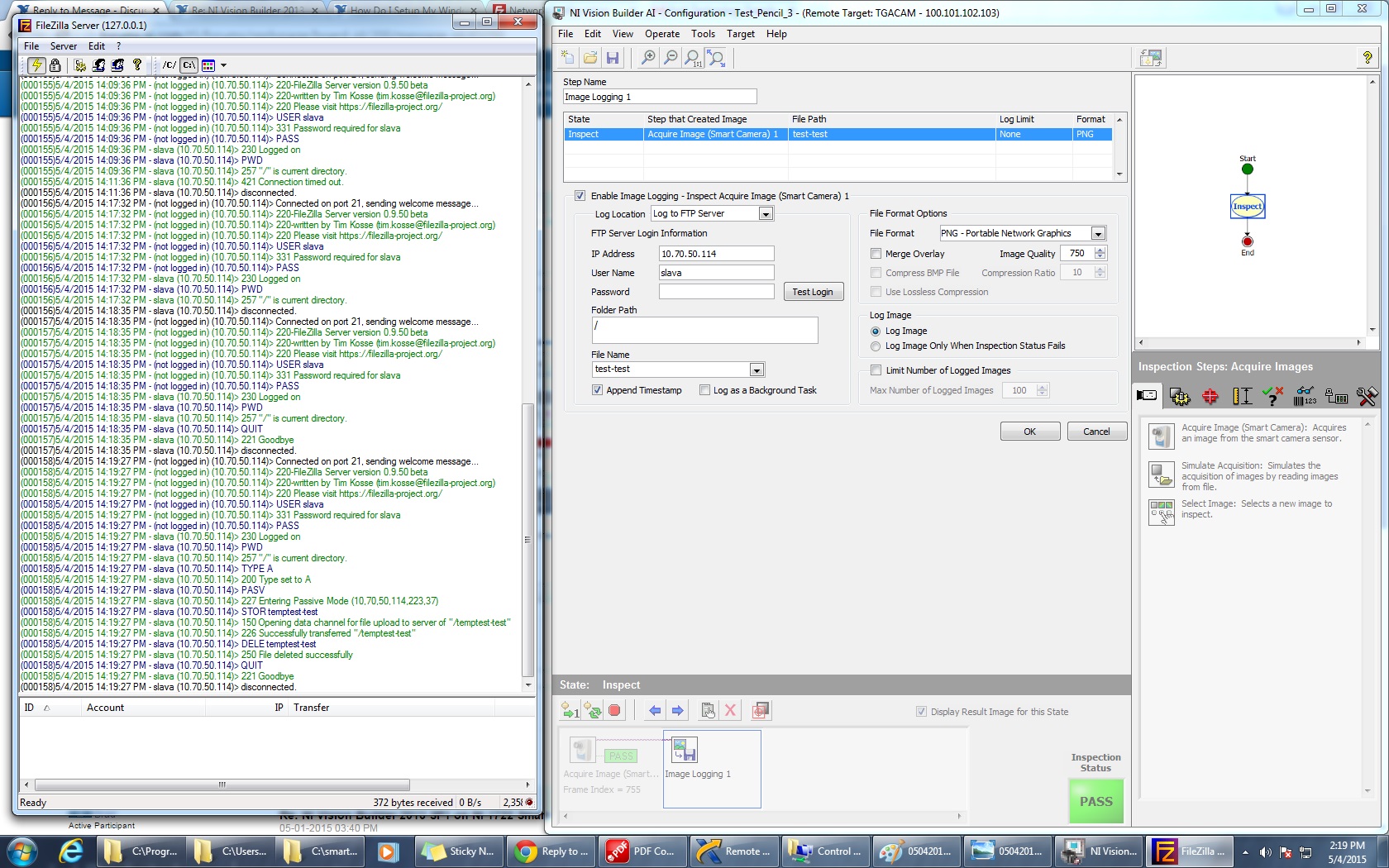

I double checked the FTP setting, but I passed the test login without problem. (see below) After clicking "OK" on the successful connection notification window, more messages came out on Filezilla page. Please give me some suggestion on FTP setting. The IP is my computer's IP. I did not set up a password for the account. I did not change Filezilla values and use as defaults. Do I need to set up anything on Filezilla?

So unfortunately when you press the Test Button, it tests the FTP connection from the PC running VBAI and not the target. Is the smart camera connected directly to your PC with the FTP server being on a different PC possibly that your host PC can see, but the smart camera can't directly see? Another possibility for why your PC can connect, but the Smart Camera cannot is if you have different FTP settings in your Vision Builder INI on your PC vs Smart Camera. Can you check the two INI files or attach them. The windows INI is located right next to the Vision Builder exe on Windows. The Smart Camera's Vision Builder.ini is located on the target at c:\vbai.

I would like to clear my problem here. The "FTP login Error" showed up after clicking the "run once" button on the top, and the "image logging" showed "failed". When I used the "Run once" button on the bottom, there is no error reported. I double checked the FTP connection on the image logging setting page. The "Test Login" showed that "VBAI successfully connect to specifed FTP server".

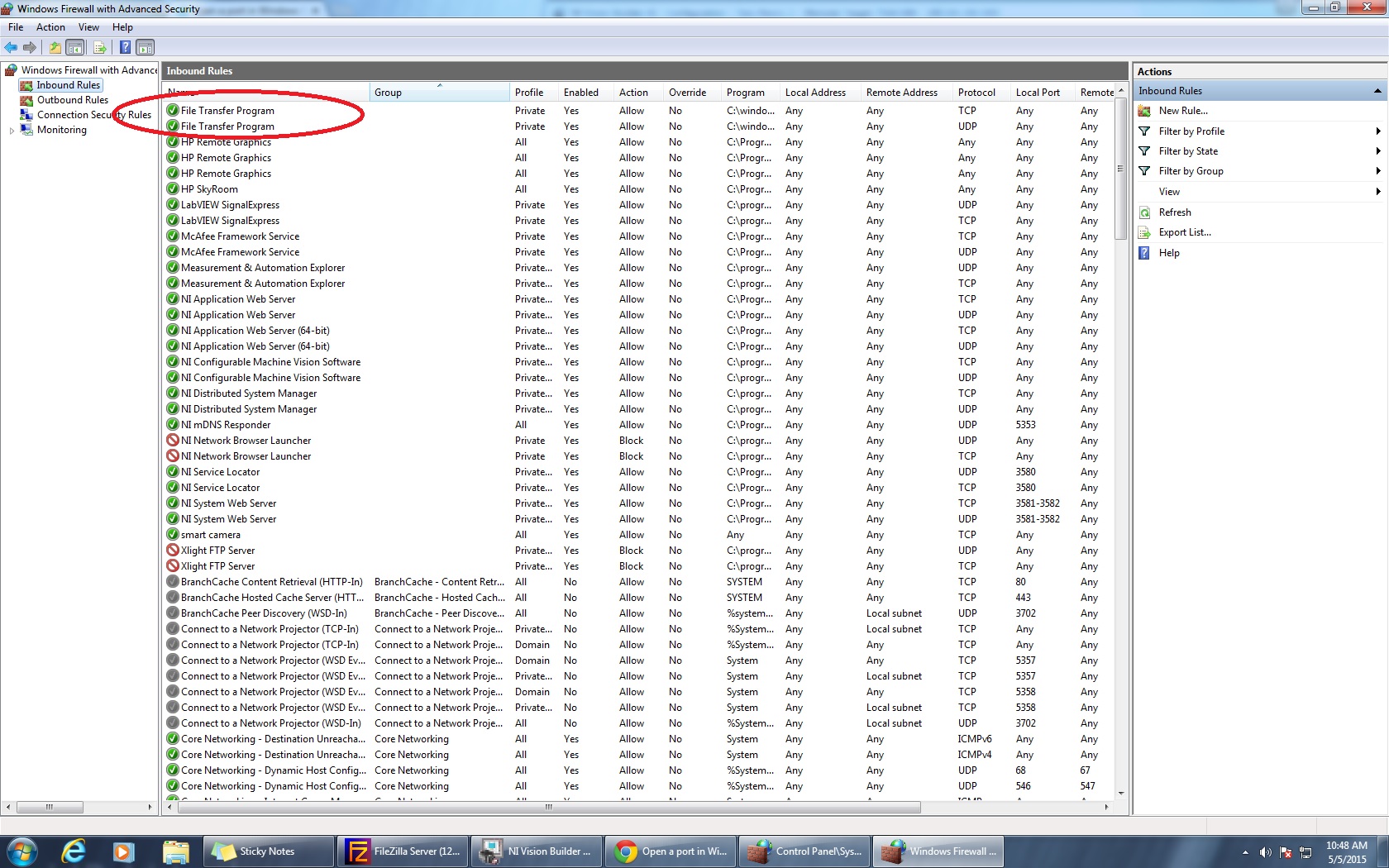

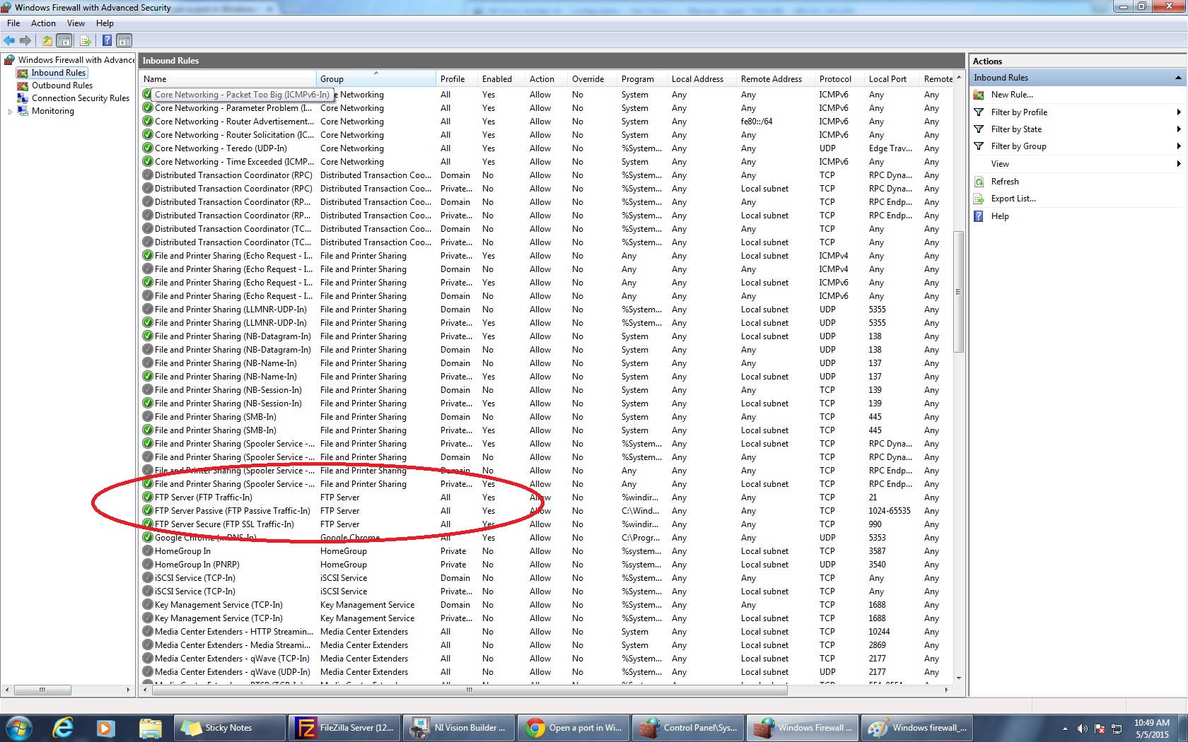

Brad, I changed the port number back to 21 from 2000 in both windows and camera folder. Image logging still shows "FTP Login Error". I also tried to change Windows 7 firewall settings as attached. I enable "FTP server", "FTP server passive", and "FTP server secure". I also enable the two "File Transfer Program". But it does not solve the error I have. I am not sure how to use the file, go port.llb, you attached in a RUN LabVIEW step. I thought we are so close to getting the problem fixed but still something there. Thanks a lot for your help.

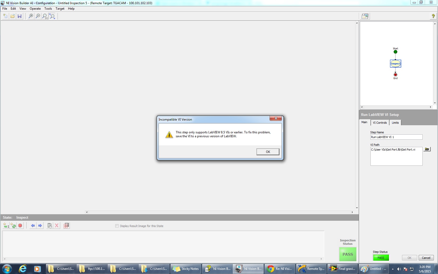

Brad, I really appreciate your advises and help here.  I am able to copy the goport.llb to camera c:\user VIs and I also be able to find "get port.vi".  However your file seems to be a newer version than my software. My LabView is version 8.6 and the VBAI I am working on is 2009 SP1. I am not sure if you have the older llb file for me to have the test. Thanks a lot. Best.
