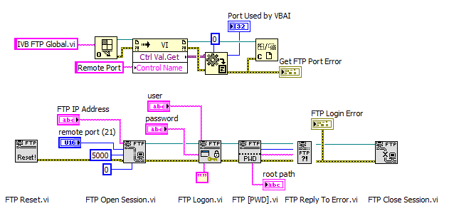

Hey allendale,
Here's what the Get Port.vi looked like (sorry I don't LV 8.6). Make sure to read the Run LabVIEW FAQ for how to save the VI so it can be distributed on targets using the LV project and building an LLB with all dependencies.
Hope this helps,
Brad
