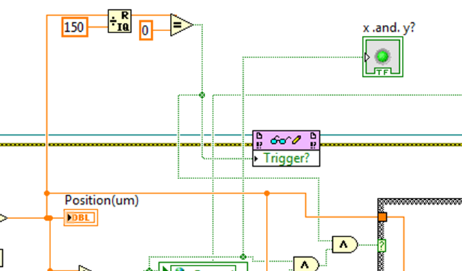

The linear encode read the stage position and I would like to take images based on the stage position.
The result shows there is uncertain delay that is not constant value.

Thank you for your reply.
I attempted to change to the synchronization based on position value from encoder, but it still has a gap between shutter (Image) and position.
I take the images every 150um position as below.
I am wondering that my first program was to synchronize the camera based on the shutter time which is generated by the RTSI. Are there any possibility reason that comes from my camera setting? I am using Sentech Camera link camera, CL202A.
