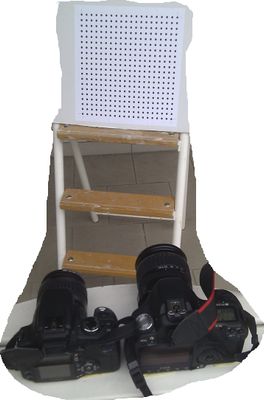

My (simple) setup is:
- Two DSLR cameras (different models, Cannon 50D and 350D)
- Different lenses, but the focal lengths were the manually set to 35 mm
- Same lighting (outdoor)
- Baseline distance ~200 mm
I calibrated single cameras using a camera model and also corrected perspective distortion. I used a grid shown above in 20 different postitions. Here, I had no problem.

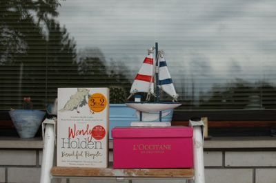

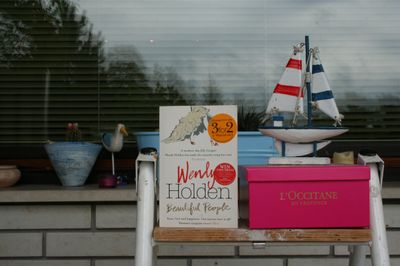

Using a small window size 7x7, I calculated the disparity for the following acquired images (an example of acquired image pair):
                                             Left image                                                                                                      Right image

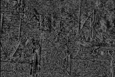

The disparity image i get (non-interpolated) is:
The depth image isn't calculated (blank image) for some reason.
What am I doing wrong? I know I made some errors by my simplified system (the cameras are not fixed, the optics is not the same etc.), but what is wrong with the resulting disparity?
Is the problem in the  vertical misalignment of the images? From what I can gather, the biggest problem is the texture matching. I expected more segmented images (more areas of equal depth). Is there not enough texture to match both images?
