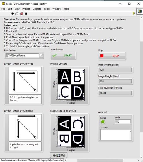

The FlexRIO driver installs an example that demonstrates how to perform random access on dram using the memory IDL and a sequence of counters. It demonstrates this by writing an image to DRAM, then reading that image back in orientation that is either mirrored, rotated, or some combination of both. Here is a screen shot of the host vi after the sample image has been loaded to DRAM, then read back such that it appears mirrored and rotated -90 degrees.
If the FlexRIO driver has been installed, you can access this example by opening the example finder and nagivating to Hardware Input and Output>>FlexRIO>>External Memory>>Random Access Pattern - Memory IDL.
