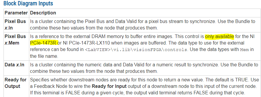

So here comes a problem, for older device like 1473R, I can use FPGA sync block to hold the raw frame, then add the processed frame.
But in the FlexRIO 7935, I can see this function, also I can drop this VI to BD, but after drop the Express VI, the VI simply don't  allow me to open the Express VI front panel, is that a bug or something?

I know, I just found it not reasonable that a later generation product doesn't contain the function used to provide.
So to doing a  image to image operation is a much more complicate.
