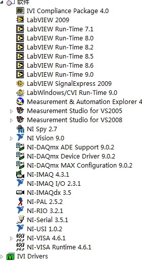

i wanna use USB camera to snap image,but i meet  the problem.i have these softwares:
and the error is:
and IN MAX the USB camera is in this position:
what's the matter?do i need more software to support the USB camera  such as LABVIEW RT module?In NI.com,there are only updates for RT module,what should I DO?

Use IMAQdx instead of IMAQ!
And be sure that you have image in MAX.
Andrey.

AS andrey has suggested use an imaqdx and check for proper interface name.

thank you andrey.it's done.really thank you.
