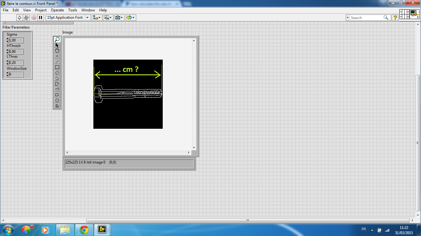

I want to put an image on labview and calculate its size in the end
(4,957 Views)
example
(4,943 Views)
Do you have the Vision Development Module for LabVIEW?  If so, I would recommend starting with the Vision Assistant Express VI.  You can apply a calibration to the image to convert it from pixels to real-world units, then make measurements of certain features in the image.
