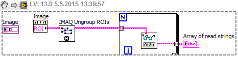

yes, just use ungroup ROIs and for loop to perform OCR in the individual region.
I don't know how you've created the ROI's, but If you want them in a specific order you can sort them prior to recognition (for example, from smallest to largest top vertical coordinate).

Hey Tmmed,
The sorting should be done by the auto indexed input and output tunnels of the for loop, so in the order that you select the ROIs they will input the for loop, then output the strings in the same order into an array.

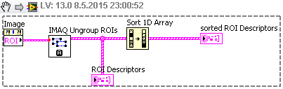

@tmmed wrote:
thank you for your help,i haven't created the ROIs yet because i didn't know how i'll continue after that,how can i sort them?thank you in advance
no matter how you create the ROI's you can sort them for example by the left global rectangle coordinate that describes the ROI:
You can use different sorting parameters, but it would involve a little bit more work.
