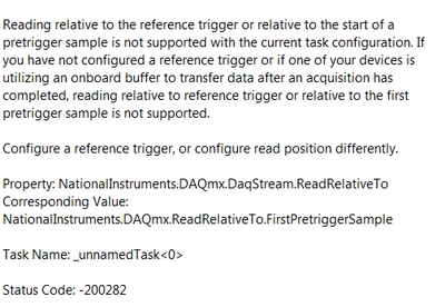

I am programming in C# trying to set up an analogue reference trigger, however I get the error: 200282.
I have configured the reference trigger:
myTask.Triggers.ReferenceTrigger.ConfigureAnalogEdgeTrigger("cDAQ1Mod1/ai0", AnalogEdgeReferenceTriggerSlope.Rising, 1, 100);
I have tried different "ReadRelativeTo." but always get an error.
