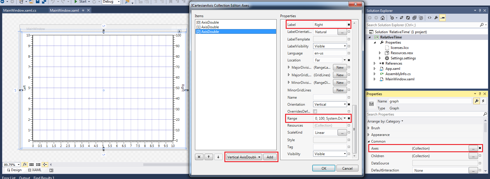

Julia's response correctly describes how to configure the Windows Forms graph control in Visual Studio. If you are using the WPF graph control, the procedure is a little different:
  1. Select the graph in the Visual Studio designer.
  2. In the Properties window, open the dialog to edit Axes.
  3. At the bottom of the collection editor dialog, select "Vertical AxisDouble" and Add two instances.
  4. Configure the Location of each axis to the Near or Far side of the graph.
  5. Configure the Label and Range to distinguish the two axes.
  6. Set a unique Name if you want to refer to the axis in code.
You can also add multiple axes in XAML or code, as described in the Configure Measurement Studio WPF Graph Control Axes and Cursors how-to topic (it is the last example in the Axes table).
