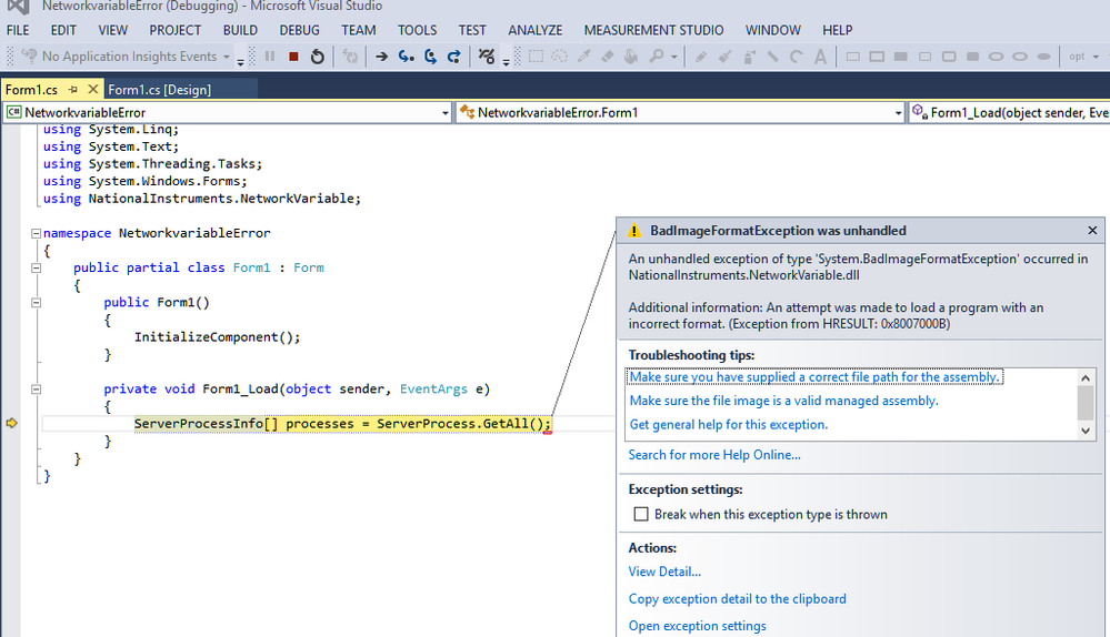

Here is an another test. I copied ninetv.dll into the bin directory. So it is found now but in a wrong format:

The last error message indicates that there is a mismatch issue, namely a 64-bit process is trying to call into a 32-bit DLL. In Measurement Studio 2015 the NationalInstruments.NetworkVariable.dll works for both 32 and 64-bit processes and We only have one copy of ninetv.dll which should also work for both.
We see that the referenced documentation which indicates in older versions did have a separate 64-bit implementation, ninetv64.dll. It may be possible that you had an old version on your system that is 32-bit specific which could cause this problem.
Can you check the version of ninetv.dll on your system?
Note that since ninetv.dll is shared by all NI products using Network Variables that it should be the version of the highest NI software on your system - in our case that's CVI 2017. The version you should download must be at least a 15.x version (since you use MStudio 2015 on your system).
Finally, is this error happening on your development system, deployment system, or both?

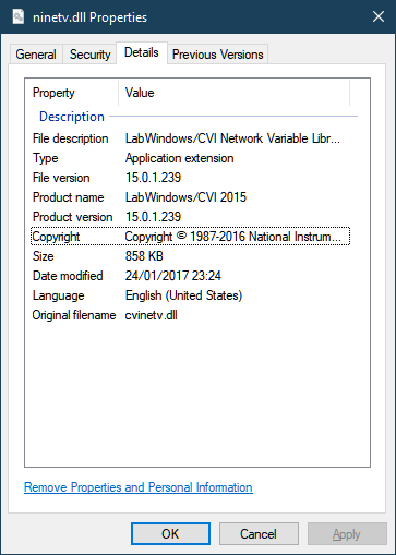

Hi, here is the ninetv.dll what is used. Version 15.0.1.239:
BR,
Ilkka
