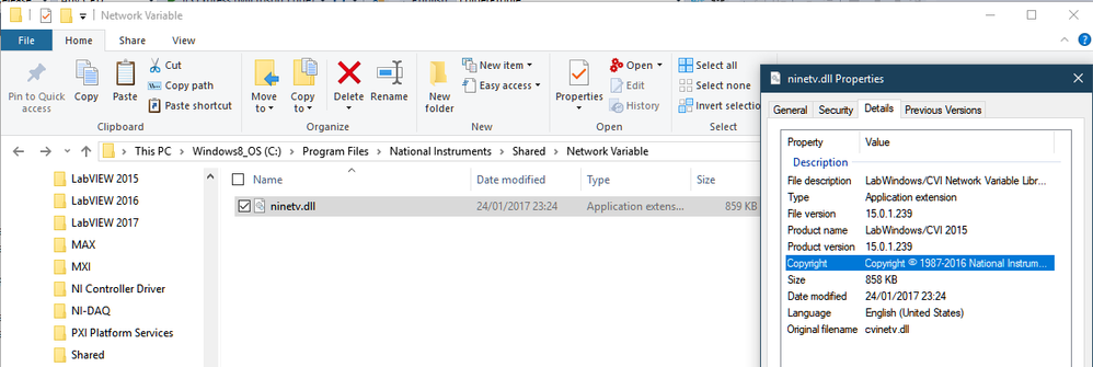

excuse of my late reply.  But it is the same 32 bit ninetv.dll in the Program Files folder in the following location
C:\Program Files\National Instruments\Shared\Network Variable\ninetv.dll
Please also note that usually 64 bit assemblies are in Program Files (x86) folder:
C:\Program Files (x86)\National Instruments\MeasurementStudioVS2012\DotNET\Assemblies (64-bit)\
C:\Program Files (x86)\National Instruments\MeasurementStudioVS2013\DotNET\Assemblies (64-bit)\
I have not found any 64 bit ninetv.dll from my Computer.
