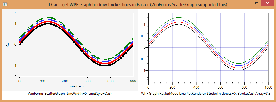

Are you saying it is as designed that the Raster LinePlotRenderer for the WPF Graph does not support changing the line thickness or support drawing dashed lines? We used to use the WinForms ScatterGraph; it exposed LineWidth and LineStyle properties to enable this.
I've attached a zip file with a WinForms ScatterGraph next to a WPF Graph (Raster / LinePlotRenderer). Is there not any way to make WPF Raster lines dashed and thicker than 1 pixel?
ScatterGraph showing LineWidth=5 and LineStyle=Dashed, WPF Raster Won't do same
(8,390 Views)
Accepted by topic author ellisda
Vector and raster represent a tradeoff between richer functionality and better performance. Improving the performance and feature support of raster rendering is one of the main focus areas for the next Measurement Studio release, but the current release only supports 1-pixel thick solid lines and rectangular points in raster mode.
~ Paul H
(8,385 Views)
Thanks Paul. You're posting here may get us up and running in Raster mode. Thank you for clarifying that it didn't make it into 2013 edition of the raster LinePlotRenderer (anxiously awaiting March 2014?)
(8,369 Views)
Just wanted to let you know that Measurement Studio 2019 added support for StrokeThickness and StrokeDashArray customization for graphs that use the Hardware RenderMode.
