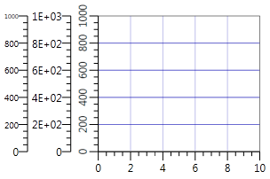

As Alex+ra mentioned, you can customize the LabelVisibility or LabelOrientation properties on the MajorDivisions of the vertical axis to change how the default labels are displayed. You can also customize the LabelPresenter, using a fixed-width format or using a custom formatter that provides fixed-width labels:

Hi, Paul!
This is much better. Now the only question is how do I combine this with ValueFormatter override? LabelPresenter doesn't allow to have both GeneralValueFormatter and TemplateValuePresenter...

I just used TemplateValuePresenter as an easy XAML-only example. When you define your own value formatter, you can return whatever UI element you want to display. For example, if you were deriving from GeneralValueFormatter, you could use code like below to wrap its visual in a Viewbox:
    protected override UIElement VisualizeCore<TData>( TData value, ValuePresenterArgs args, UIElement existingVisual ) {
        var viewbox =
               existingVisual as Viewbox
            ?? new Viewbox { MaxWidth = 16, StretchDirection = StretchDirection.DownOnly };
        viewbox.Child = base.VisualizeCore<TData>( value, args, viewbox.Child );
        return viewbox;
From your XAML snippet though, it looks like you just want to specify a .NET "0.00" format. In that case, you can use the StringFormat property provided by Binding:
    <TextBlock Text="{Binding StringFormat=0.00}" />
