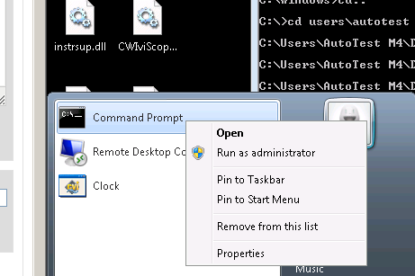

I copied over the cwui.ocx (and its dependencies), from MStudio 8.1.2.143 to a machine with Windows 7 installed. I then manually tried registering the ActiveX control using Regsvr32.exe cwui.ocx. It failed with errors if I did not run the command prompt as an administrator; once I ran the command prompt as an administrator and then registered the ActiveX with administrative access, it registered properly. Thus, I believe this's a permissions issue.
Confirm that you're running all of this with Administrative privileges (Windows 7 is very particular about its permissions for each program), and I bet that's the culprit.

Your suggestion (in reply to  my inquiry about how to install cwui.ocx) worked perfectly. I really appreciate the help.
