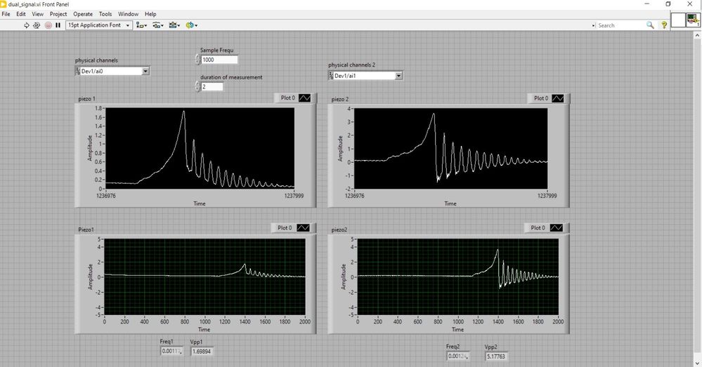

Piezo1 connected to a0, Piezo2 connected to a1. How to get these two signals separately using (DAQassistant or piezo1 excitedpiezo1 excitedpiezo2 excitedpiezo2 excitedDAQmx) - DAQ USB 6363?
In the following figure, the front panel window shows two images - (piezo1 excited-it affects both graphs, piezo2 excited separately - it also affects both graphs), acquiring two piezo signals.
If piezo1 is excited, the signals are acquired in both graphs (Graph1 - piezo1, Graph2-piezo2) giving responses in both graphs.
If piezo2 is excited, the response signals are acquired in both graphs (Graph1 - piezo1, Graph2-piezo2), giving responses in both graphs.  We need to take a response separately using DAQ assistant or DAQmx.
How to solve this problem?

The issue seems electrical and not a software one, looks like the Ghosting effect expected in a Multiplexed AI, please refer to the below links for more details,
https://knowledge.ni.com/KnowledgeArticleDetails?id=kA03q000000YHy6CAG&l=en-US
https://knowledge.ni.com/KnowledgeArticleDetails?id=kA00Z000000P84RSAS&l=en-US
https://knowledge.ni.com/KnowledgeArticleDetails?id=kA00Z000000P9mKSAS&l=en-US

The VI image is attached for your reference. In this LabVIEW block diagram, how can able to add a dummy channel in between ai0 and ai1 to avoid the ghosting effect.
Tell me your suggestions.
