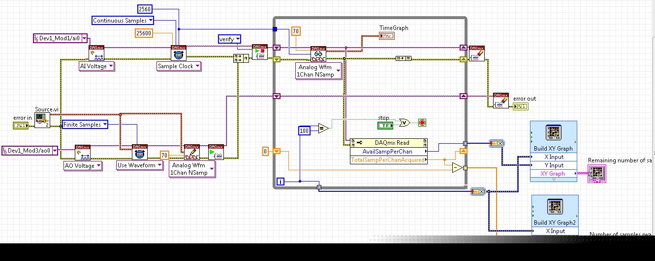

  • Sine sweep signal generated through Ao 9263 and response from sensors stored through Ai 9234
  • Acquisitions rate for Ai up to 25.600 KS/s, Sinesweep read from TDMS (60 seconds 8.533 KS/s)
  • Graph need to be update 10 times per seconds. Program need to respond for Stop button thus I decided to take continuous acquisition.
Simple program was created to exclude another part of the final program. Currently in Hardware Ao/0 is connected to Ai/0 to see what is going on.

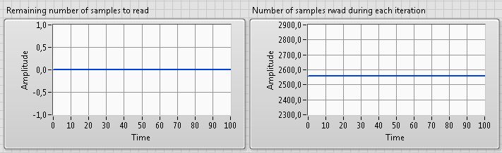

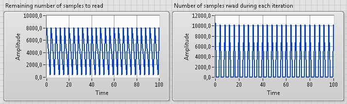

Problem is visible especially when iteration will be plotted against: 1) available data to read, 2) data read during last iteration. Below are screen shots for situations: when programs works ok and when have delay ( works not ok)
Worinkg ok: no remaining data and every iteration 2560 data are read.
Program not working properly: DAQmx  did not read data in every iteration, thus huge stack is growing.

In attachements please find MainVI.vi plus Source signal for generation
