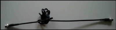

Provide a clean (low R AND low L)  power path (keep them close and twist them slightly if possible) , add some filter to get down the dI/dt , identify the ground loops .  (Use your scope with a little coil as a sensor at the input and catch some magnetic fields can open eyes)
THEN to clean the last spikes (out of the DAQ) to get the last ppm use chokes  BNC ring core filter 2.jpg
