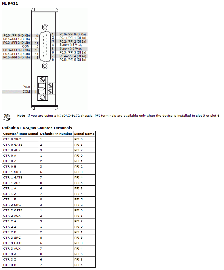

The configuration I mentioned is the default pin assignment for Counter 0 onboard your cDAQ chassis seen below.
 Your configuration would still work but they are not the default pin assignments for any counter reading an encoder (A, B, Z terminals) and you would have to utilize some property nodes to reroute the signal to their appropriate destinations.

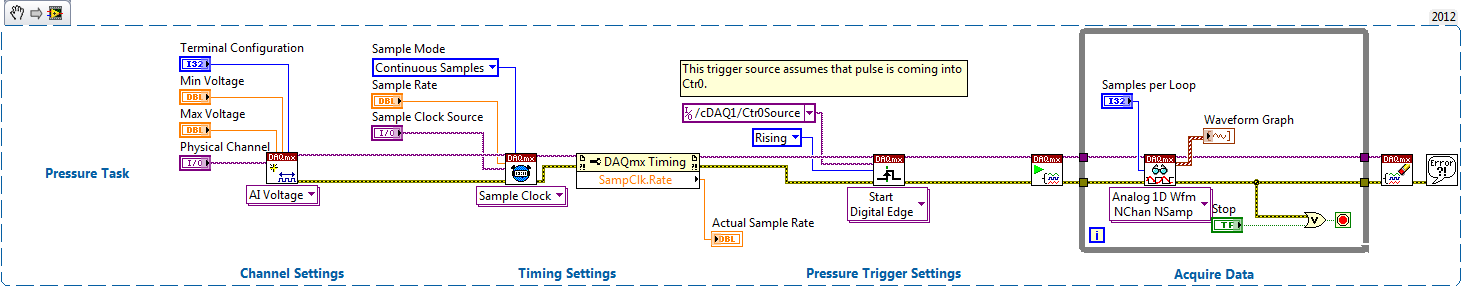

I took a look at your VI and was not quite sure what you were trying to implement and why you were utilizing digital task for your pressure transducer and encoder. Please take a look at the snippet of code below which demonstrates how to trigger your analog pressure task based on the first Pulse to the encoder source (A terminal). You will also need to set up a counter task for your incremental encoder.
Also, could you clarify this statement you made on you May 16the post “The trigger needs to start and wait for about 100ms and then stop”. The trigger will only start the pressure task from acquiring data once as displayed above so more clarification on the feature you are seeking would be helpful.
