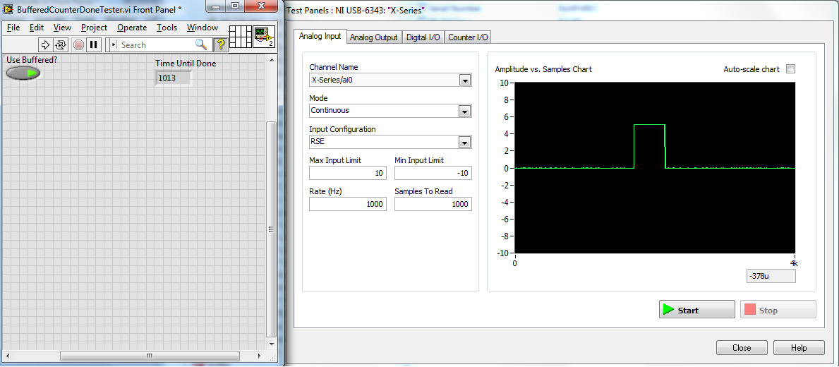

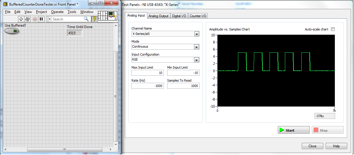

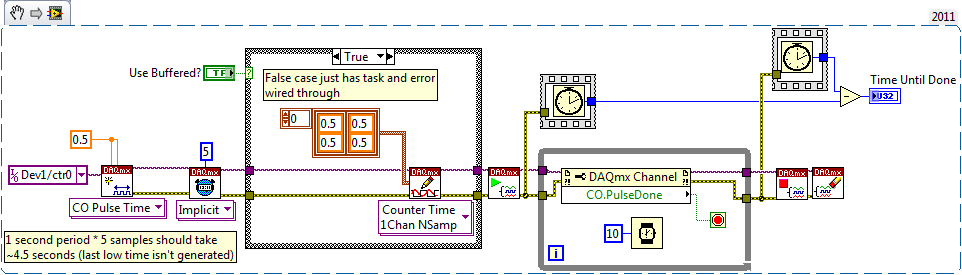

Here's my simple tester VI:

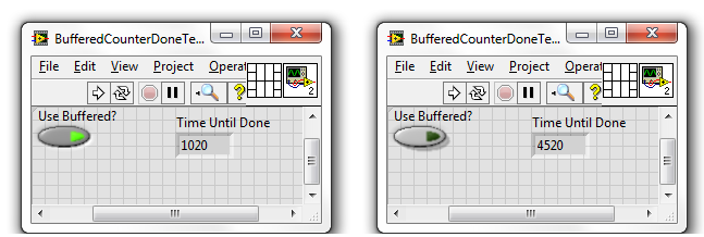

In the buffered case the loop exits after ~1 second, while in the non-buffered case it exits after ~4.5 seconds:

I'm in need of the non-buffered behavior (toggle once all the pulses have been output) for a buffered task.  I can't use Is Task Done? or the equivalent property because in my case I have a finite retriggerable buffered counter output (being retriggerable it is never "done" according to Is Task Done?) and I need to know when all of the pulses have finished generating (I'd prefer to not have to burn another counter to monitor this).  Maybe it's just late in the day and I'm overlooking something but I can't think of any other way to do it--the property node seemed like it should work but it only does so for non-buffered counter output tasks.  I'm using an X Series.

I have tested your VI on USB-6343 X-Series card (with NI-DAQmx 9.5.1) and I got the same results as you reported. Refer to the images below:
I have filed a CAR on this issue: CAR #: 364784

Thanks.  The only reason that the buffered case isn't outputting all 5 pulses is that the task is being stopped immediately in software once the Pulse Done property goes high.  The only complaint I have is that Pulse Done is going high when it shouldn't.  The 1 second time represents when the first pulse of the pulse train has completed (buffered counter outputs don't use the initial delay for whatever reason so the full low time is waited before the pulse is started, see here).
