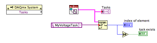

Does this work for you? You can compare the task name passed to the subroutine to the list of all tasks. If the indexing returns a value of the index, you know the task has already been created.

Unfortunately, that code doesn't seem to work on my system. Running it, I am prompted to located the shared framework 'nilvaiu.framework', which doesn't seem to be part of the NI-DAQ install on my machine. If I cancel out of the dialog box, the property node executes but simply returns an empty array.

It looks like the property node is a DAQmx component, not a DAQmx Base component.  I cannot find any DAQmx Base property nodes.
dmsilev,
Try replacing the Tasks property node with the DAQmx Base get tasks.vi.  It is not on the DAQmx Base palette. It is a subVI of DAQmx Base Create Task.vi.  One caution: When using a subVI which is not on the palettes, be aware that they are usually not documented well and are subject to changes in future versions of LV.

If you were not aware, DAQmx Base is written in LV and almost all of the block diagrams are not p[rotected so you can look inside and see how things are done.

Hi Lynn,
That worked. Thank you very much both for the specific suggestion and the pointer to digging through the source for additional nuggets.
