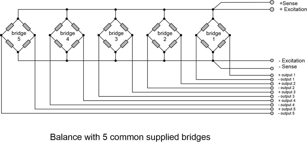

Please share a simple electrical diagram of your "5 balance bridges" to ensure I am on the same page.
(2,503 Views)
see my drawing!

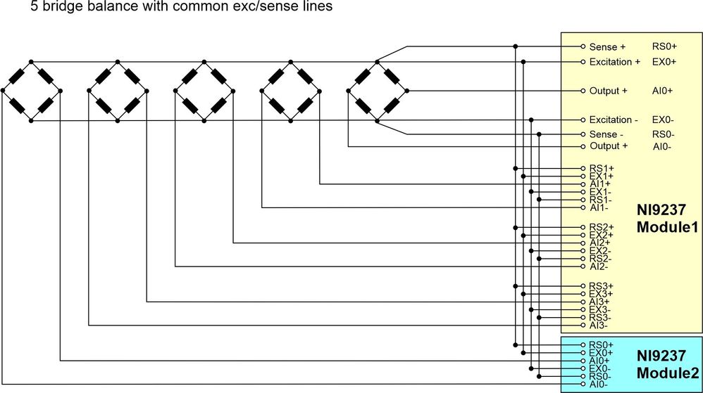

I need to measure the 5 bridges on a cRIO with more NI9237-modules (only 4 channels per module).
Questions:
1. Is the module compensating the measured sense voltage on the excitation leads or
    does it only use the sense lines to divide the bridge output by sense line voltage to
    get a ratiometric output (mV/V)?
    I suspect that the second statement is the truth, because the module can not
   correct an externally fed excitation voltage!
2. Connecting a 5 bridge balance on two modules (external excitation)
    Then the wiring according the drawing must be correct!Connections 5 bridges balance on SGM.jpg
