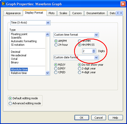

Change it.

ok . I did change . But still the original waveform is in milli sec and processed waveform is showing in minutes. I have attached the part of the program . Can i get the processed waveform in milli sec only .
