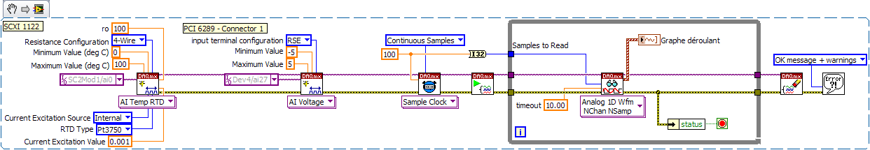

To acquire from SC2Mod1/ai0 and Dev4/ai27 at the same time, add both channels to the same task:
18807i9A6CD27C0763B4A9
