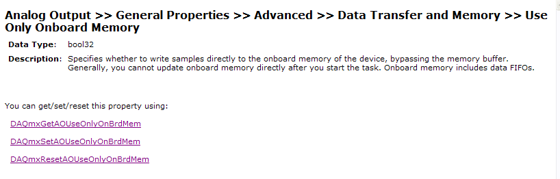

Hi sentieri,
The function is actually listed under the NI-DAQmx C Properties tab in the Reference Help.  For your convenience, here's a screenshot from the DAQmx C Reference Help:
Instead of NULL, the second input should be the channels that you want to set to use only on-board memory.  I hope this helps,
-John
