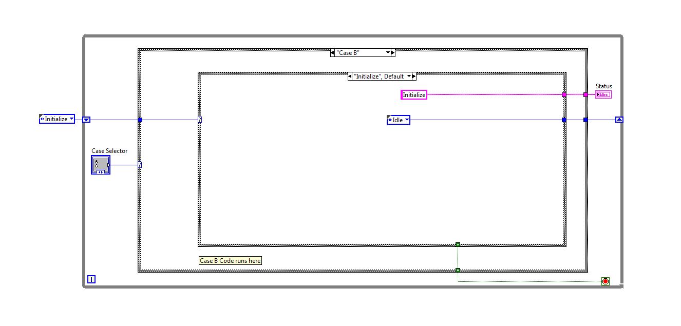

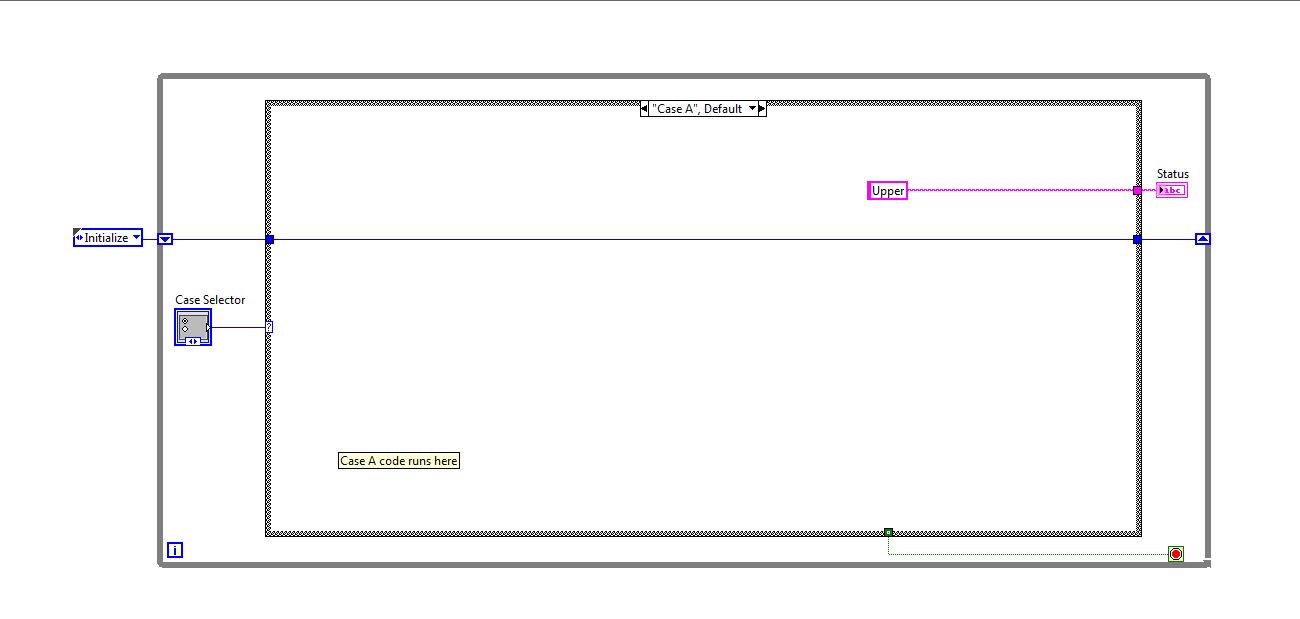

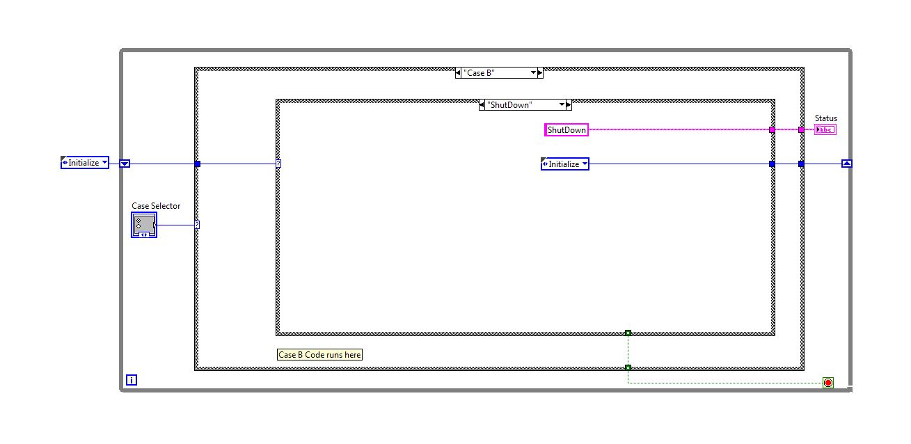

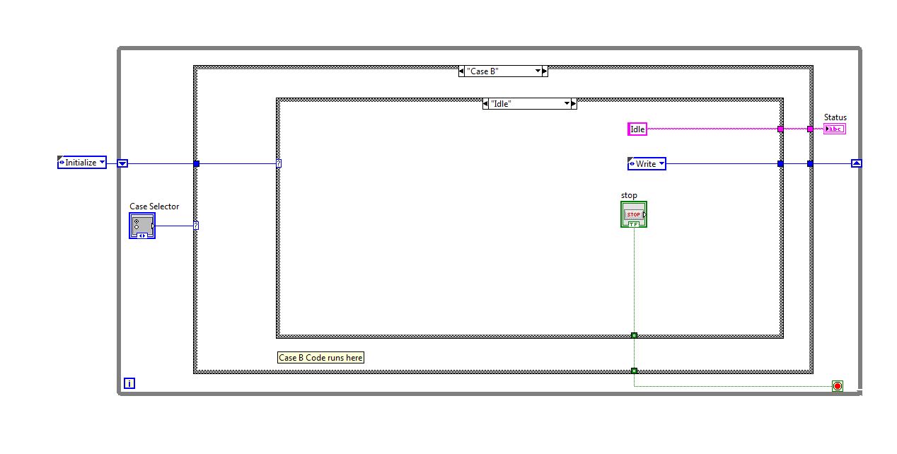

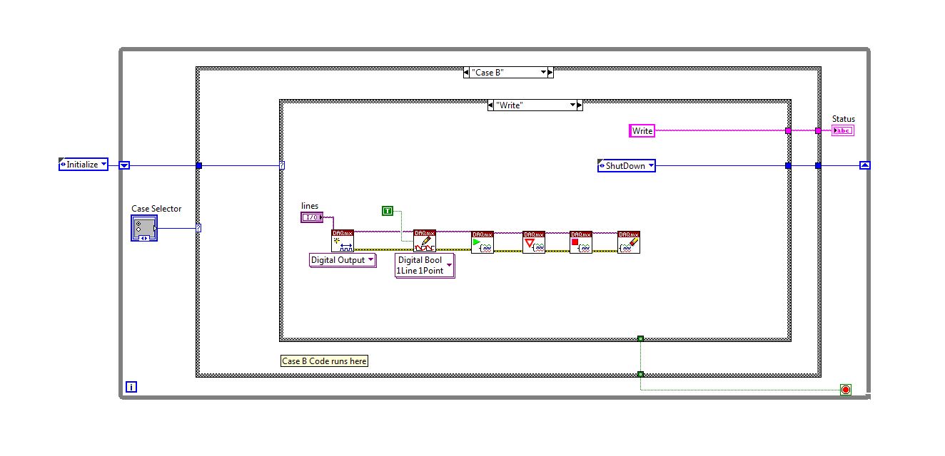

Lynn,
Thank you for your reply. I gave it a try to your recommendations. I am not completely done and I think I need some more guidance.
I created a shift register inside while loop and inside case B (excluding my actual code). I did not include my actual code because I wanted to make it easier t0 test and debug. Please look at the picture below
At this moment if I run my VI with Case B, my DO gives 5V and it never stops. And if I am running my case A, stop button does not stop my actual program and I still have 5V in my DO.

pkunwor,
A few things to point out in your current program:
1). I would recommend using a case structure with a timeout case in the "Idle" state containing the stop button. The event structure should respond to the stop change event, or the timeout should execute in an appropriate amount of time as Lynn mentioned: "The state machine only stays in any state for a few tens of milliseconds before checking for the stop command or other data which will cause it to change states"
Depending on how you want your program to execute the timeout case can send the state machine directly into the write case, or you can add a control on the front panel that the user selects to send the state machine into the "Write" case. You can use another event case in your event strucuture to respond to this "Write" control.
2). Stopping and clearing the task should occur when your while loop exits or in the shutdown case, not the same case as the write. Take a look at one of the Measurement I/O examples in the LabVIEW shipping examples for a reference on the open --> read/write --> close structure for DAQmx tasks.
Will M.
