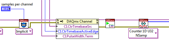

You'll need to add the "ticks" input to the Create Channel VI:

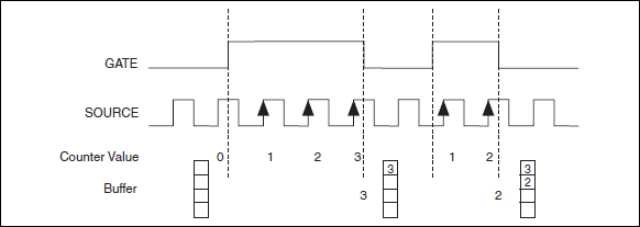

Indeed, this would be measuring the width of the gate in terms of pulses from the PMT.  The value of the counter will reset after every gate pulse and would look something like this:
In this case, Implicit means that the value is latched into a buffer at the end of every pulse on the gate signal.

Thanks for the extra info--it sounds like you changed the instance of DAQmx Read to be N samples but still need to wire the samples per channel input to the DAQmx Timing.vi
Using samples per channel is another way to set the buffer size.  For finite tasks (which is the default), the buffer size = samples per channel (unless otherwise specified).  The default samples per channel is 1000.  Wiring this should allow you to tell the task exactly how many consecutive gates to measure--regardless of the buffer size the task will end after samples per chanel acquisitions have been completed.
