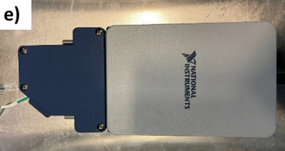

Regarding the Chassis, the equipment currently have the NI 9212 cDAQ module installed. I have the picture at the moment which is attached below.
In this regard, I have one more question. Since there is a multifunction NI 6003 module installed in the equipment. Is it possible to use 6003 to read data from both pressure transducer and load cell if they have let's say 4-20 mA output. Is it possible that NI 6003 read the amperes and convert the corresponding value via a function to the physical property being measured. I assume that the sensor will come up with their calibration certificate and they generally operate in a linear function.

You can add an external resistor to convert the 4-20mA loop to Voltage for the USB 6003 to read and you can configure the DAQmx channel to read current with a external sense resistor and provide the physical scaling factors to get readings from DAQmx APIs in the physical units instead of mA or V.
Since the 6003 has a fixed +/-10V range, you need to scale the 4-20mA to +10V so you get the maximum resolution and accuracy.
https://www.omega.co.uk/techref/das/4-20ma.html
You essentially need a 500 ohm or 499 ohm 0.1% resistor to give you the best measurement results.
