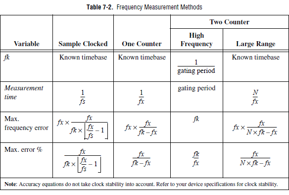

It's possible.  You should be aware that there are tradeoffs to the various counter frequency measurement methods (accuracy vs. measurement time).  The X Series User Manual includes a chart that shows the accuracy and measurement time of these methods.
This doesn't include the accuracy of the timebase, which is 50 ppm (.005%) on the 6221 according to the specifications. The Sample Clocked method is not available on the 6221 (only the X Series and non-9172 cDAQ support this), which is a shame since this method would be my recommendation if you had that option.  Since this method is not available, you could use the Large Range or the High Frequency method.
    1 Counter: 18.51% accuracy @ 12.5 Mhz, so this is out of the question.
    2 Counter Large Range: N (the divisor) would have to be 32 @ 12.5 MHz to give a measurement error of .49%.  N=32 would require 160 ms to complete a sample @ 200 Hz (not bad).  Higher values of N will give better accuracy but take longer.
    2 Counter High Frequency:  Would take an entire second to achieve .5% accuracy @ 200 Hz, but this 1 second gating period would give a resolution of 8 ppm accuracy when measuring 12.5 MHz (remember though, the timebase is 50 ppm).
So, the Large Range method will give the most accuracy at 200 Hz.  The High Frequency method will give the most accuracy at 12.5 MHz.  Either could be used to achieve the .5% accuracy requirement that you have in a reasonable amount of time across the range of your input.
If you are interested in measuring the entire range of your signal with better accuracy, I'd suggest looking into an X Series (e.g. 6320) for the Sample Clocked method.  If .5% is sufficient then you'll probably be OK with what you have currently although either of these methods require the use of both counters.  Here is a link showing how to program a continuous counter acquisition using the High Frequency method.

1. In this fx = the measured freq. (e.g.. 12.5MHz), fs = 100Mhz, fk=100Mhz.  Is this correct?
2. Can I also use the 20Mhz time base instead of the 100MHz?
3. Is there any other internal time base?
4. if I put the data into the equation for Max err %  ( fx=12.5, fk=100, fs=100  all in MHz)  I get  -1.78%.  IS THIS CORRECT?

Hi Rafi,
fx is indeed the measured frequency (for you, 200Hz to 12.5 MHz)
fk is the internal timebase (the best choice is 100 MHz, which the driver should default to.  Other options are 20 MHz or 100 kHz)
fs is the sample clock rate.  The board will take a sample of the count register on every tick of this clock.  The clock can be what you want, but should be slow enough to guarantee a complete period of your input signal during each period of the sample clock.  The slower the sample clock, the less measurement error is introduced.  Let's say you use one of the other counters to generate a 10 Hz sample clock signal.
Plugging in the numbers I get:
    0.105 ppm for fx=200 Hz
    0.100 ppm for fx=12.5 MHz
In short, the 50 ppm (.005%) accuracy of the counter timebase would essentially represent the entire source of error using the above parameters.
When fs is greater than fx, the measurement is actually undefined (the driver should return an error if two sample clock edges occur without any edge of your signal to be measured).  The formula will result in negative numbers in this case, like the result you obtained.
