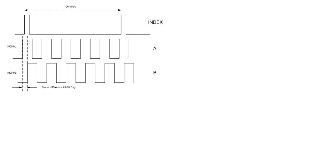

Attached is the exact encoder signal I need to produce.  I need to simulate 3 encoder, thus, 9 lines.  However, I output only 1 encoder at a time.
Which signals do I need to use?  I have 6 PFI pins available + 3  DO.  Can I use a combination of DO and PFI?
Please elaborate as much as you can...

3.  From the drawings, I see that A and B are 100Khz == 10 usec cycle == 5 ms High & 5 ms Low
     Wave B is shifted  2.5ms from A (not 5 ms as you said).  Am I right?
     Also, the index seems 2.5ms and not 5 ms as you mentioned?  Am I right?

1.  This is good.  You have enough counters to output all 3 signals, but it sounds like you only have 6 PFI lines available and you need to have 9 total different outputs without having to change your external connections.  This is why you need to use DO (digital output) for at least one of the three encoder signals.
2.  Digital Output tasks can generate a sample clock on the 63xx boards.  So, you can write an arbitrary digital waveform, set the clock to 400 Hz, then use this clock as the basis for timing your counter outputs.
3.  Thanks for pointing that out, I didn't notice the 100 kHz label on the left and was instead going off of the label on the top that indicates 100 msec between your index pulses (10 Hz).  There are 5 periods of A and B that occur in between the index pulses, which would imply that A and B are only 50 Hz signals (10 msec high and 10 msec low).  My suggestion is still the same, but your waveform and timing might be different depending on what the actual signal you want to output is.  I could give more specific advice with an accurate, consistent diagram.
4.  It would indeed take 1 counter to output each of your A and B signals (you only have 3 DO lines available for 6 signals, so it makes more sense to use the counters for A and B to be able to use your 6 available PFI lines).  I had assumed (incorrectly) that A and B were only 50 Hz, not 100 kHz.  To generate the 100 khz signals you would need to update your DO at 400 kHz (which is still achievable).  I can't tell from your diagram what the phase of the z index needs to be relative to A and B.  If the transition does not need to occur in the middle of A and B, you could instead use the counter output as a sample clock for DO and get away with a much lower update rate.  The 632x can clock DO waveforms at 1 MHz so it shouldn't be a problem either way.
5.  Yes.  From my last post, "the waveform for the DO task would be [0011 0000 ...] with enough 0s at the end to bring the total to 40 samples".  I put the 0s in the front to achieve the offset from the counters, but like I mentioned earlier I didn't realize the frequency of the A and B lines was not to scale with the rest of the drawing so you'll need to change this depending on what the acutal signals need to be.
6.  You can't have a delay of "0" on a counter output task.  The counter will not pulse high until the 2nd tick of the timebase that is being used.  If the DO is the master task, then this 2 tick delay is significant.  If CO is the master, then 2 ticks of the internal timebase (100 MHz) is only 20 ns and probably doesn't matter.  You have drawn the z index pulse going high during the middle of a counter output pulse, so if this is a requirement it makes the most sense to use the DO as the master.  If not it might make more sense to use the CO task as the master.
7.  If you use the A output as the master, defining 010000... would put your index pulse on the 2nd rising edge (or falling edge if desired) of the A signal.  This is not how the diagram is drawn.
8.  You mentioned that you ahd 6 PFI and 3 DO lines available.  Thus is seems to make the most sense (to me at least) to use the counters on 2 PFI lines for A and B, and use 1 DO for the Index.  This way you could implement all 3 encoders (1 at a time) without having to change external connections.  You could do it another way if it makes more sense to you, but I think it would be easiest to use the counters for A and B and DO lines for Index.

I rechecked the encoder waveform requirements with my client and would like to present it to you in order to get it right this time...
REQUIREMENTS
1.  A & B are 100 Khz and shifted by 2.5 usec (B after A) as was shown in the diagram.   (10 usec cycle waveform,  5 usec high, 5 usec low)
2.  Index is 2.5 usec (not ms as I wrongly indicated before)
3.  Index is unsynchronized with A or B.  All we need is 2.5 usec every 100 msec  (10 hz)
4.  I have 6 PFI lines and 3 DO lines.
5.  I have 3 encoders but need to implement just 1 at a time.
6.  All the card (NI 6250) counters are available.
 IMPLEMENTATION
6.  As you previously recommended I will use PFI outputs for generating A and B and DO for index.  (if you still think this is the best configuration)
7.  Can you specify, based on the above data, how to implement this task?    (this is my first waveform generating task, therefore, I feel a little unsure as to how to set up the timing...)

Hi Rafi,
Thanks for the clarification, and for pointing out that you're using a 6250 instead of an X Series card.  This changes things slightly, but I still think you should use the counters to output A and B and the DO to output the Index, given that this fits the lines that you have available.  The fact that Index is not synched with A and B makes this a bit easier:
Here's how I would implement the task:
A:  Use a continuous counter output task.  Simply configure the counter output task to be 100 kHz, 50% duty cycle.
B:  You have two options (in either case, start this counter task before you start the counter task above):
        i)  Use a retriggerable, single pulse counter output task.  Trigger this off of the internal output of the first counter.  The initial delay and low time would be set to 2.5 us, the high time would be set to 5 us.
        ii) Use a continuous counter outupt task with the same pararameters as A.  Use the arm start trigger from the other counter to start this task.  Set initial delay to 2.5 us.
        I personally like option i) above, but you could configure the task either way.
Index:    Implement a clocked DO task with the appropriate waveform.  Since you're on M Series the clock has to come from another subsystem, so I suggest to use FREQ OUT.  It is programmed the same as a continuous counter output task.  You would need a clock output at 400 kHz (1/2.5 us), but frequencies availalbe on FREQ out are 10 MHz (or 100 kHz) / (1:16).  So, you can set Freq out to 2 MHz (10 MHz / 5), and just output a higher number of samples to be able to generate your index signal.  The 6250 can update DO at up to 10 MHz so this should be acceptable.  The waveform to be generated would be [1 1 1 1 1 0 0 0 0 0 0 0 0 0 0 0 ...] with enough 0s at the end to make the array 200 000 points long (updated at 2 MHz this would be equal to 100 msec of data).
To answer your general questions:
All of the internal clocks on your M Series are derived from an on-board 80 MHz oscillator, which may be PLL'ed to a 10 Mhz reference clock if desired.  So, in the above case the DO timing is somewhat related to the counter output timing (i.e. it won't drift) but the timebases would be different.
The 6250 only has 2 counters (+ FREQ OUT).  The 63xx boards (which I thought you were using before) have 4 counters.  On X series boards Digital Output tasks can generate their own sample clock, while on M Series DO tasks must use a clock from another task (or from external). So, on M Series you need to use some other resources to generate your clock for DO, but on X Series you do not.
