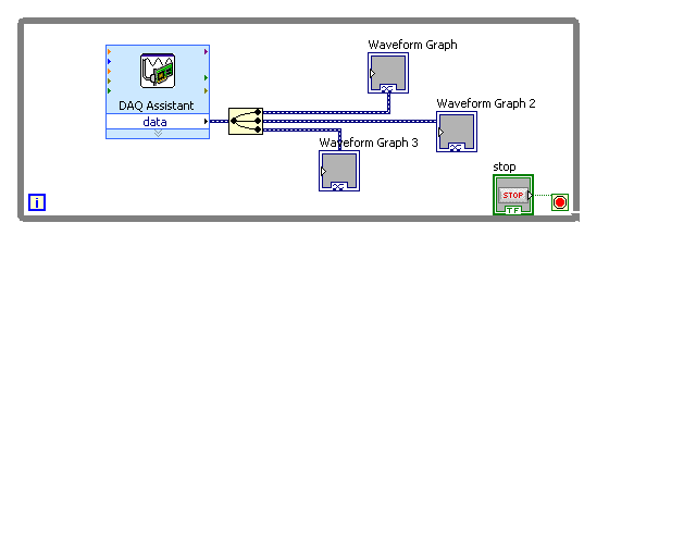

My hard drive crashed and they finally got a new one up and running, but my old VIs aren't working. Originally I had LabVIEW 8.6.1. After the crash I updated to 9.0f2 (32bit). I had backed up my VIs. I did not realize I needed to back up any custom scaling inside of the DAQ Assistant. I looked through my notes and figured out what had used but Split Signals still is not working correctly. I have a PCI-6221 and a BNC-2090A. When I graph the split signal all the channels show the same wave form even though only one is connected to anything.
Any ideas what I am doing wrong?

When you don't have a channel connected, what you are seeing is normal. Search for the topic 'ghosting'.
