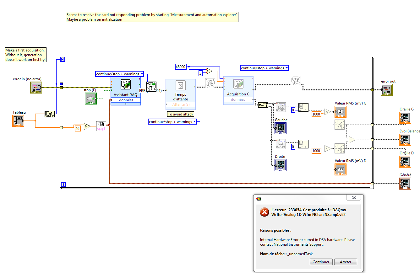

When I start my application right after having plug my acquisition card to my PC (or after boot), the DAQ Assistant give me the error 233054:
I did not found any explaination on this amazing tool which is internet, so  I come here! 😉
The only way I fount to go forward, is opening NI-MAX, ask to do an acquisition, ask to do a generation (which one works) and then, I can go back in LabView and launch my program!
The problem seems coming from initialization. But I don't see what I have to do to have it working every time! Any idea?

I found a corrective action request which documents this behavior as a bug in the driver setting an incorrect DDS clock rate. Try upgrading to the newest version of DAQmx and try again.

I just check the compatibility between daqmx driver and labview. I notice your daqmx driver version 9.7.5 is not compatible with labview 2009, that why, you have this deal.
The latest version of daqmx with labview 2009 is 9.7 see below
DAQmx and LabVIEW Version Compatibility:
http://digital.ni.com/public.nsf/allkb/B0D5630C0A50D5C6862578E800459248
So may you uninstall 9.7.5 and reinstall daqmx 9.7 see this link
Uninstall Software
http://digital.ni.com/public.nsf/allkb/AC6ED75D3D93375686256E8E00245F0D

As promised, I've followed your instructions and it seems it works!
Thanks a lot for your help! I would'nt have find it alone!
