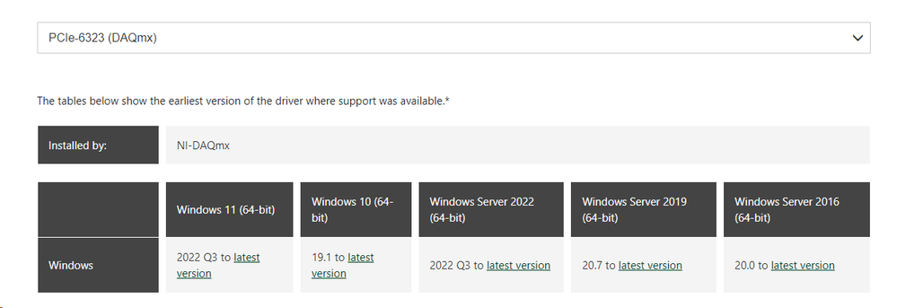

Are there compatibility issues with Windows 11?

Do you have DAQmx 2022 Q3 or latest installed?

I have the latest DAQmx installed
